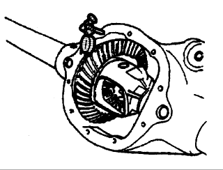

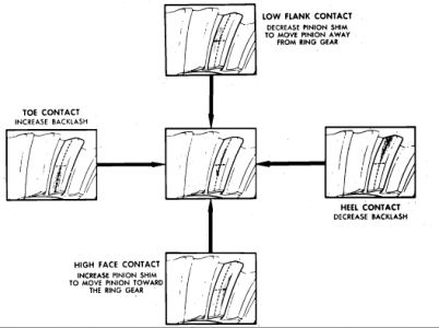

KEEB55
  • 6 POSTS
hello i have a question and here it is...im installing a new rear differential carrier into my truck because my old one was shot. i did not take the pinion out and i was told as long as i did that then i didnt need to measure backlash or anything all i had to do was have new side case bearings pressed onto the new assembly and put it back in with the old shims and torque it down and i was told this by a few people so i did this and i put my axles in to turn the differential and it barely turns and it takes alot of strength to turn the axle. i can barely turn the driveshaft as well...help i gotta get this fixed. any ideas? ps everything went back together fine there was no fighting to get it in. the ring gear lines right up with the pinion gear. did i do something wrong? or is it supposed to be really tight cuz my old one wasnt that hard to spin
Oct 19, 2020 at 11:11 AM (Merged)
SCOTTY DEE
  • CAR REPAIR CONTRIBUTOR
  • 592 POSTS
Which rear axle does it have?
• Borg Warner
• Corporate and Eaton
• Dana/Spicer Full Floating Axle
• Timken/Rockwell - 12 Inch Ring Gear
