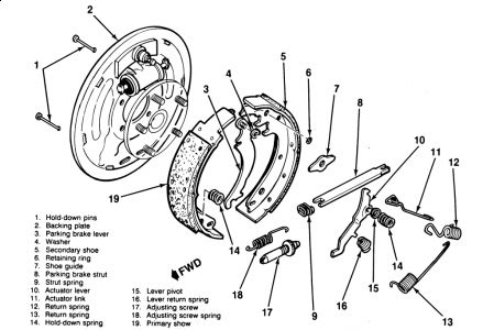

Rear Brakes assembly. Not sure how to put together or what parts if any I need to save from old ones?

This help? Check out the diagrams (Below). Please let us know if you need anything else to get the problem fixed.
