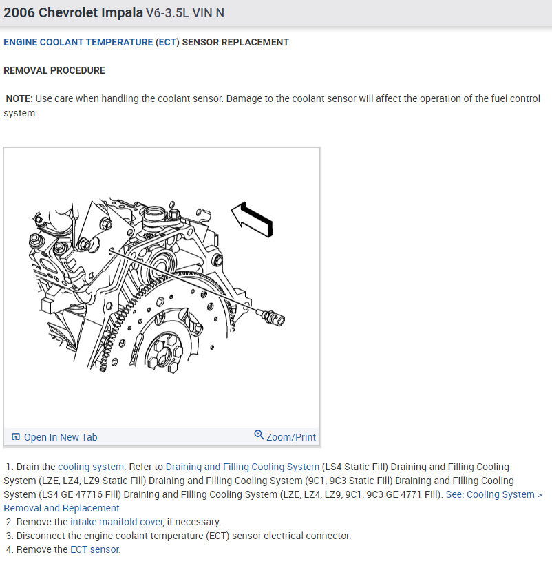

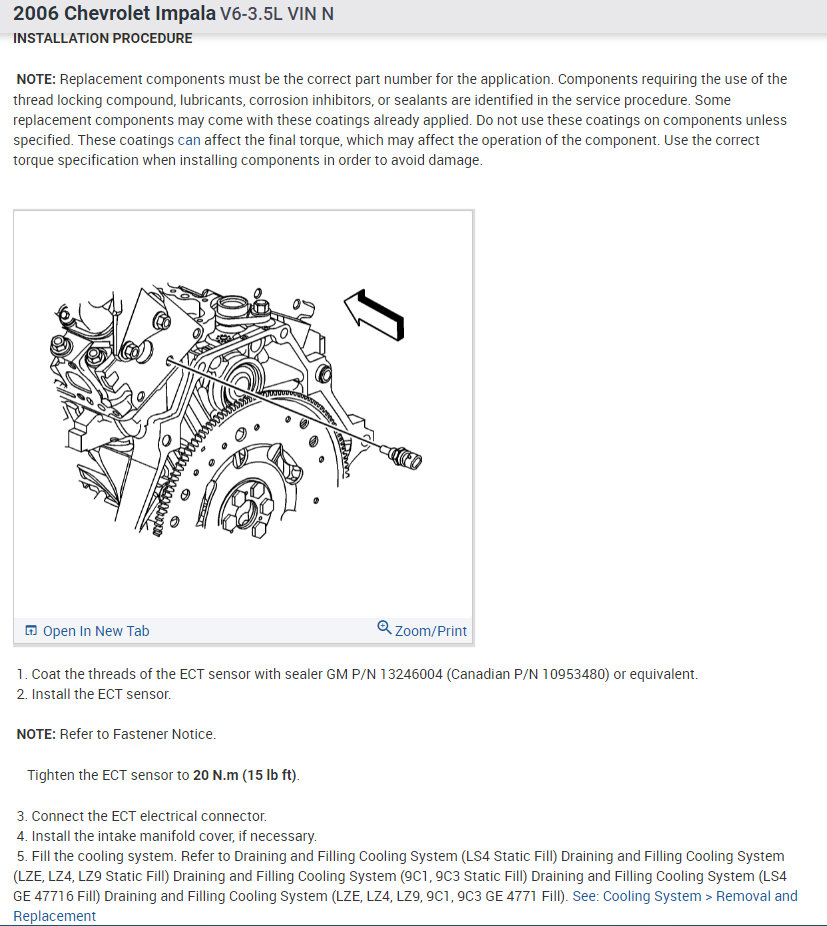

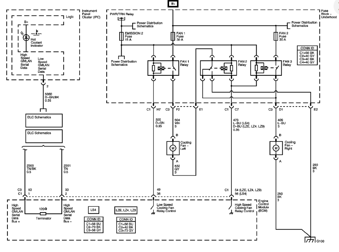

It sounds like you might have an issue with the coolant temperature sensor.
A coolant temperature sensor essentially tells the computer how hot or cold the engine is, in return the computer triggers the fan when its hot and changes fuel map accordingly.
It is not sending the correct signal to the fan module for it to start on time.
Do check to what is the actual temperature of the engine while in operation. As you could have a faulty gauge.
https://www.2carpros.com/articles/how-a-coolant-temperature-sensor-works
https://www.2carpros.com/articles/symptoms-of-a-bad-coolant-temperature-sensor
I have attached the diagrams for your reference.
