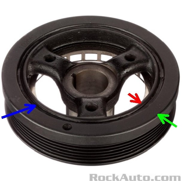

CARADIODOC
  • CAR REPAIR CONTRIBUTOR
  • 34,309 POSTS
First clear up my confusion. It sounds like you replaced the power steering pump previously for some other problem. Is that right?
The rack and pinion steering gear can cause loss of power assist when the Teflon rings on the spool valve leak, but that never comes on suddenly as you described. In fact, GM had a real big problem with what we call "morning sickness", in the late 1980's and early 1990's. The symptom always is the same. No power assist first thing in the morning for the first ten to twenty seconds, but only when turning in one direction. Over the next few weeks or months, it will take longer and longer for the assist to come back, and eventually turning the other way will be affected too.
Given the overheating at the same time, I would suspect a belt problem, specifically a rusted spring-loaded tension-er that is not keeping the belt tight.
Another thing to look at is the vibration damper. On many engines, the outer ring is the drive pulley for the serpentine belt. If the gel that is bonding that ring to the hub lets go, it can spin and not drive the belt.

CARADIODOC
  • 34,309 POSTS
Here is a photo of what your vibration damper looks like. The green arrow is pointing to the outer ring, which is the pulley. The blue arrow is pointing to the bonding material that holds the ring to the hub. Sometimes you will see that bonding material looks like it melted and/or sprayed around the area. Sometimes they look perfectly fine, even when the ring is broken loose.
To check for that elusive cause, put a chalk mark or piece of tape on the center hub by the red arrow, and another one on the outer ring, by the green arrow. Now run the engine for a least a minute or two. When you stop the engine and inspect those two marks, they should still be lined up like they were when you planted them. If they have move in relation to each other, that bonding material has let go and the assembly must be replaced.
