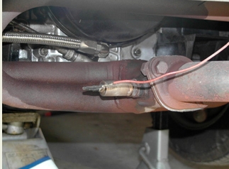

I need to replace the O2 sensor n my cobalt and I'm not sure where to find it and how to do it. I've been told it's not hard and don't take that long, but I can't even seem to locate it....any info would really help!!!

shouldn't be hard to find, they are exactly where we described them to be in last posts.. should look similar to picture below...just disconnect battery, then raise vehicle and locate the sensor on the exhaust. disconnect sensor connector and unbolt from exhaust..
