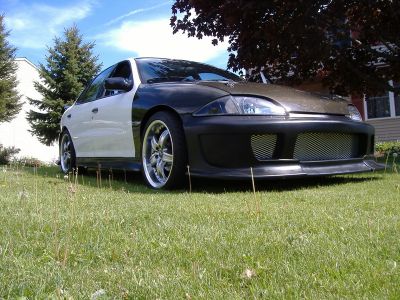

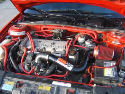

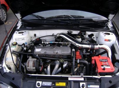

Well I am a happy owner of 01 cavalier Ive got 2.2L auto, Its my second new cavalier car, I had 2000 2.2L 5 spd also, was a very great car, 2.2L engines are pretty good motors, And easier to work, 2.4L are good as well, But alot of man labors to fix parts, They also have alot of performance parts for the 2.4L motors, For me I am not into racing, But my car is pretty decent, For the cars power, Its been very relieble. Only thing that sells the Z24 is the aftermarket rims & body kit. I will inclose a pic of a nice looking 2.2L car
