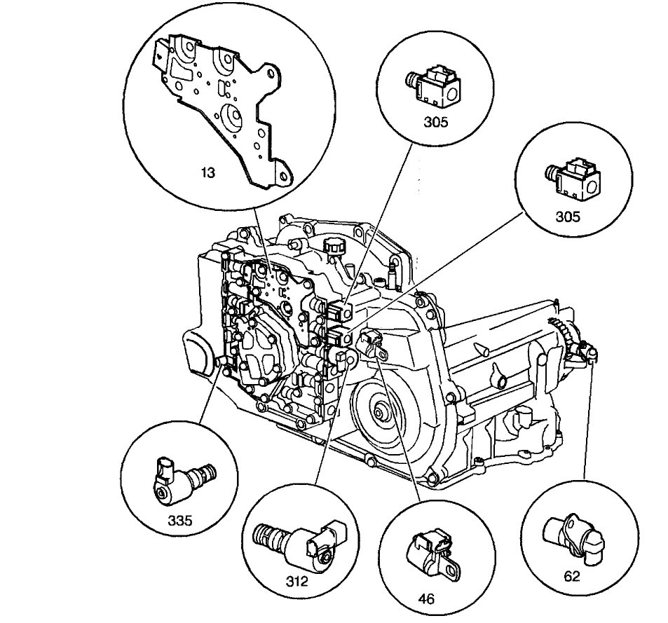

I was driving to work a couple of weeks ago and the trac off light came on out of the blue and the car began to shift hard between gears. I have since parked the car because of this issue and it cannot be good on the transmission to drive it this way. I do not have any other light on with the trac off light. I called the dealership in my town and they said that if it were the wheel sensors, the ABS light would be on, but it isn't. I disconnected the battery for a couple of hours and re-connected it and the trac off light was off and everything was fine. I drove the car about 1/4 of a mile and the light came back on and began shifting hard again. What can possible be making the trac off light come on and make the car shift hard. HELP!!

It sounds like you have a transmission shaft speed sensor that is out and needs to be replaced.
I would run the codes to see what comes up.
This guide can help as well
https://www.2carpros.com/articles/abs-warning-light-on-easy-repair-guide
Trac Off Light when it receives an out of range input signal from the enhanced traction system in regards to the wheel speed sensors thru the ABS unit. They said the ABS light should come On if there's a problem with the wheel sensors-sometime it doesn't work that way-Bring it in they got the equipment to troubleshoot that problem and then maybe the computers that are involved.
But lets go for the easy fix first.
Here are the sensor locations in case you get an sensor code.

I got around to scanning the car and nothing came up but I heard from a shop that the input speed sensor can cause this as well so me and a buddy installed a new one now the car works again! ya!. thanks for your help guys ;)
