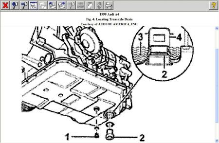

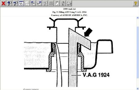

How can I fill or change the transmission oil. There is no stick to fill or change the transmission.
Monday, September 1st, 2008 AT 9:35 PM
KHLOW2008
MECHANIC
41,815 POSTS
Hi rastae6,
You need to remove drain plug 2 to check the fluid level. # 1 is for draining the fluid.
There is a special tool to fill the fluid.
