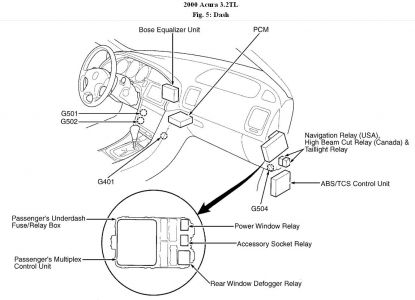

My rear window defroster stopped working--my car is in Like new condition but is getting old--thoughts?

Hi jsmalone1,
Have you checked the fuse and relay for the rear defogger?

I did check the fuse--how & where do I check the relay?

Refer to diagrsm for rear defogger relay location.
Try swapping with other relays to test.
