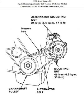

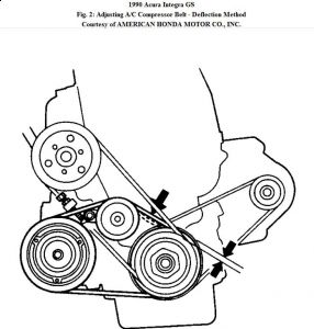

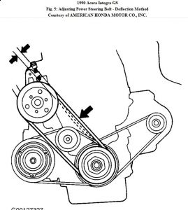

How to replace a alternator belt on a 1990 Acura Integra?
Sunday, March 14th, 2010 AT 3:06 PM
KHLOW2008
MECHANIC
41,815 POSTS
Hi sphillipss,
You would need to remove the AC and power steering belt before the alternator belt cold be removed.
