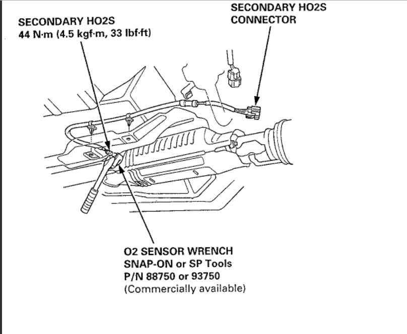

My car is throwing a P0138 O2 Sensor High Voltage (Bank 1 Sensor 2) CEL error code.
-Is "Sensor 2" the down-stream (post catalytic converter) oxygen sensor?
-Where is "Sensor 2" located?
-Would replacing the down-stream oxygen sensor fix this problem and get rid of the CEL?

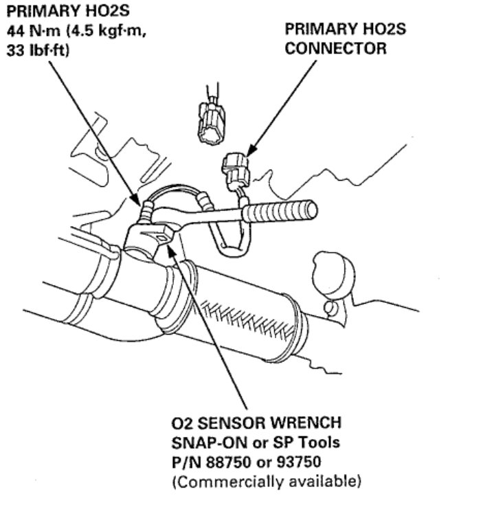

The bank one sensor 2 is post catalytic converter sensor. Here is a guide and some diagrams (below) that will help you get the job done.
https://www.2carpros.com/articles/how-to-replace-an-oxygen-sensor
and you will need to raise the car safely
