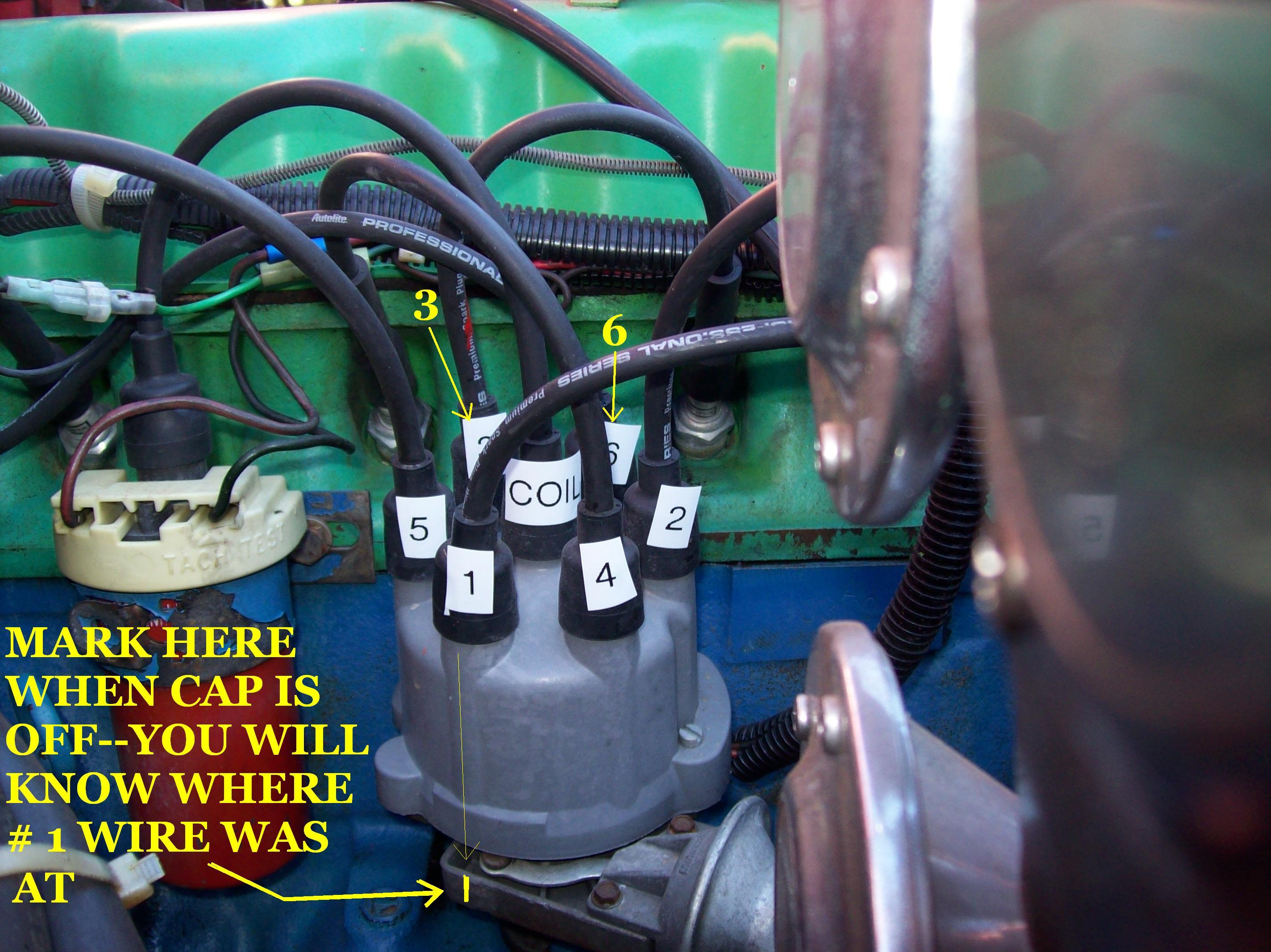

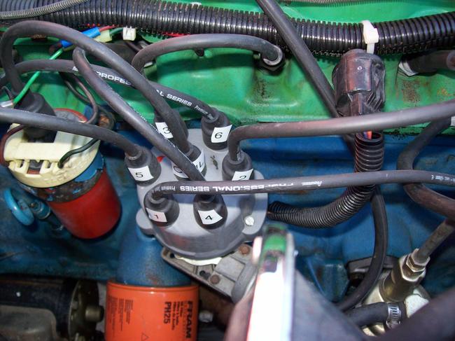

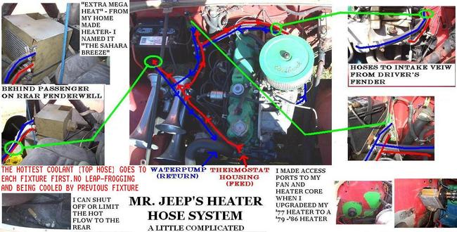

I HAVE REDONE MY LINES TO MAKE THEM NEATER--THE RETURN IS IN THE SAME PLACE AS IT ALWAYS WAS. IT HUGS THE FRAME ON IT'S WAY BACK TO THE TANK
I MUST GO TO WORK SOON---I'LL BE BACK ON HERE ABOUT 2200 HRS EASTERN
HERE'S SOME PICS I MADE IN THE PAST--I HAVE A 6 CYLINDER--I'LL TAKE MORE IF NEEDED

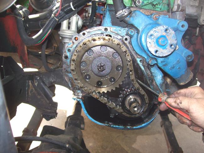

MINE IS A 6 CYLINDER, I HAVE MORE ROOM, AND IT'S ON THE OTHER SIDE OF THE ENGINE.
MY PUMP IS ALMOST IDENTICAL TO AN 8 CYLINDER'S, I CAN CHANGE MY FUEL PUMP IN LESS THAN 5 MINUTES.....JUST GUESSING MAYBE LESS THAN 10 ON A 304
THIS PIC IS OF A 360 GOING INTO A FULL RESTORATION---ALMOST THE SAME AS YOUR 304, AS FAR AS FUEL PUMP LOCATION
YOUR "HOLE" IS PROBABLY BLOCKED OFF WITH A PLATE, TO KEEP IN YOUR OIL...REMOVE IT, INSTALL THE PUMP IN IT'S PLACE

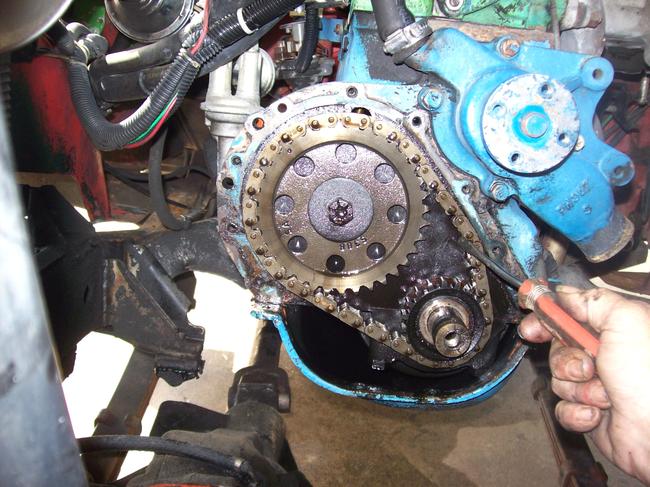

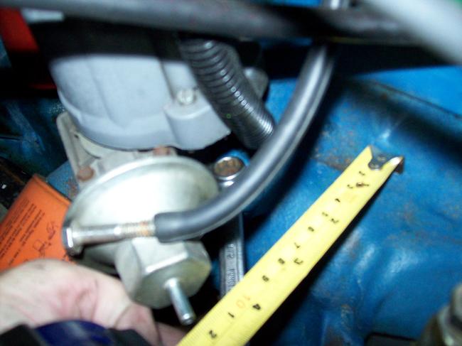

ANOTHER SHOT OF THE PUMP MOUNTED ON THE ENGINE, THIS ONE IS A 304----THE OTHER PIC WAS A 360 AT MY OTHER ANSWER. BOTH STILL THE SAME PUMP LOCATION
THERE IS PROBABLY A PLATE THAT YOU WILL REMOVE AND DISCARD---IT WAS STUCK ON THERE WHEN THE ELECTRIC PUMP CAME INTO PLAY
SOME PEOPLE JUST LEAVE THE OLD MECHANICAL PUMP IN PLACE TO COVER THE HOLE (USUALLY NOT!)
I STILL HAVE NO WORD ON HOW YOUR FUEL SYSTEM IS SET UP----NO RETURN? NO 3 PORT FUEL FILTER?
I CANNOT SEE ANY OF THE FUEL SYSTEM IN YOUR PIC?
DO YOU UNDERSTAND WHAT I MEAN ABOUT THE RETURN LINE AND 3 PORT FILTER?
LOOK AT 1980 1J-9 THIS IS ANOTHER VIEW OF PUMP OPERATION (NOT LOCATION) THIS IS NOT SHOWN IN THE 1977 SECTION OF "TKB" AT MORRIS
THIS IS REALLY A SIMPLE THING TO INSTALL
I MAKE IT EZer BY BUMPING THE ENGINE AROUND UNTIL THE ECCENTRIC IS SORTA OUTTA THE WAY OF THE PUMP ARM
---ALIGN THE GASKET AND 2 BOLTS IN THE PUMP
----RUN THE 2 BOLTS IN HALFWAY OR BETTER WITH YOUR FINGERS INTO THE SIDE OF THE MOTOR
---THE CONNECTION ON TOP GOES TO THE FILTER
---CURVED PORT ON THE PUMP [SUCTION OR INLET PORT) IT SORTA IS POINTING DOWN, IT HOOKS TO THE FUEL TANK OUTLET LINE (NOT THE RETURN LINE, IT IS SEPARATE, HAS IT'S OWN MISSION AT THE FUEL FILTER)
