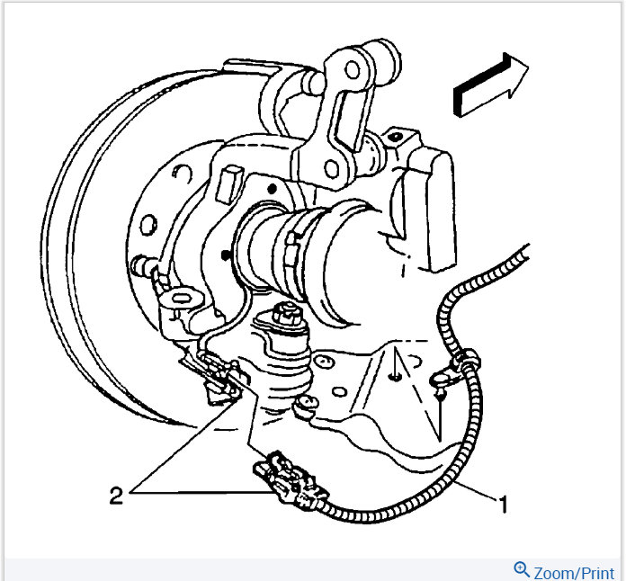

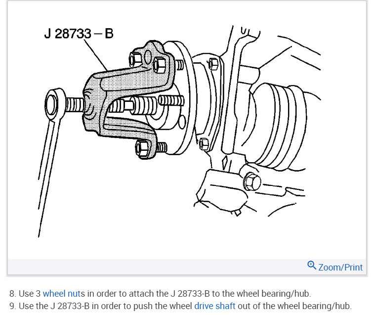

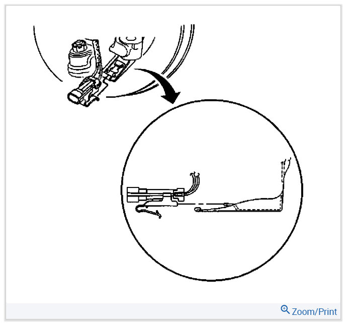

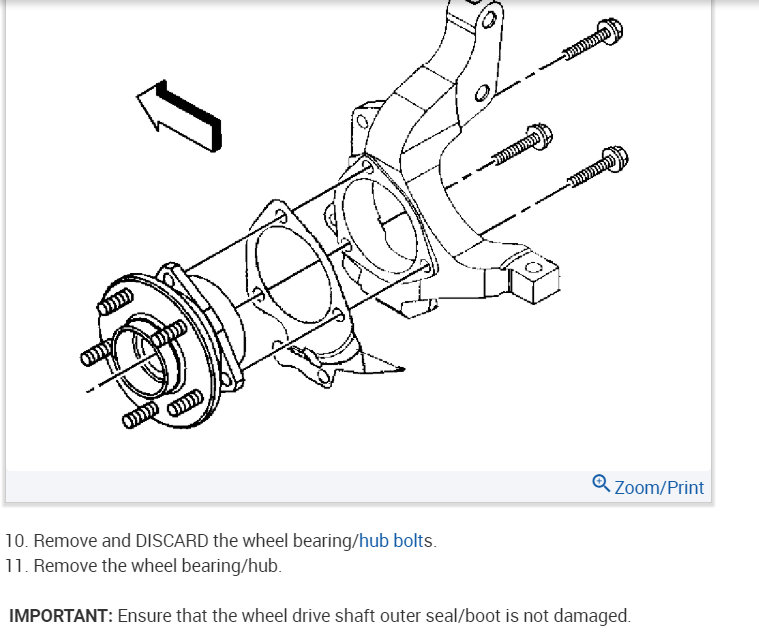

Check and see if the hub assembly isent bad, the speed sensor is built in to the assembly, the sensor goes bad, leading for the ABS/Traction Control to activate and always stay on in the info center in the car...hope this helps....I had the a similar problem has to replace to hub due to the bad sensor...if you do it youself the hub is a pain in the but to get off the axel....
