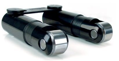

Lifters follow the camshaft lobes which dictate how far the valves open (lift), and how long they stay open (duration). Lifters come in different configurations such as; solid, hydraulic, roller, mushroom, all of which work on the same principle.
Solid lifters have no hydraulic adjustment and rely on the valve lash (air gap) to be manually set at the stem of the valve where it contacts the rocker arm. Solid lifters are used mostly in racing applications where higher engine rpm and long duration can damage normal hydraulic lifters.
Roller lifters are exactly as the name implies, they are designed with a roller wheel and needle bearings that ride along the camshaft. These lifters reduce drag caused by friction and are found in most production vehicles.
